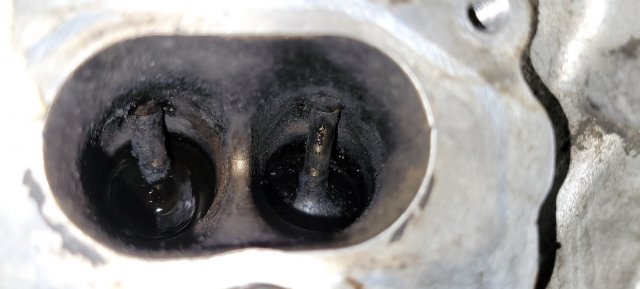

My brother 2010 Audi Q5 with 160K mile. I help him walnut blast the intake last weekend.
Before Pictures
My old 2011 Ford Flex Ecoboost at 146K miles back in 2019. Before I walnut blast the intake.
Before Pictures. I used the CRC Intake Valve 3 time on the flex. I don't think it help much.
