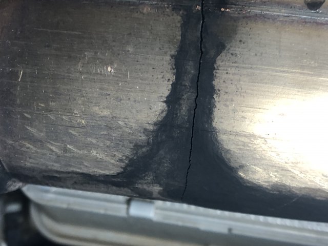

Have a real good look at the cats for weld and pipe fractures. I’m on number 3. 2020 with 52k

Yeah, I didn't see any issues with the cats. Is it pretty obvious?

In my case it was. Get car on a lift or jack it up. When cold grab pipe after the cat body. Move while looking at the weld. Just looking at the cat may not expose the break at the weld. Enjoy
