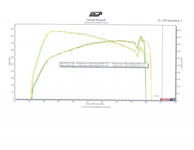

Grosse Pointe, MI, USA
This is pre-turbo upgrade. Stock I’m told is ~320awhp which is ~20% drivetrain loss vs the 400hp crank. So that would make this ~568 crank. I only care about wheel horsepower but I know many want to know crank to compare to the numbers they always see from manufacturers.
Going back post-turbo this Wednesday.

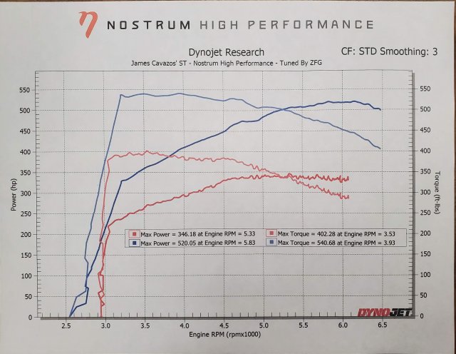

Old thread, but does anyone have SAE numbers? STD tends to inflate the numbers from my experience.
Gurnee, IL
Holy crap!
Do you have a mod list on this ST?
In your opinion, could this power be made using E85 and be driven daily safely?
280
465
Marinette, WI, USA
#20
Holy crap!
No there is not currently enough fuel system on the market.
