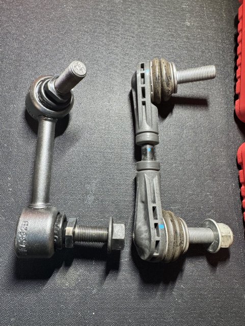

You don't have any issues with geometry or the sway bars binding up after lowering?
If getting the aFe rear bar you can opt to get these which will help keep the bar level if you decide to lower and the angle of these align better with the aFe bar which does not angle in at the ends like the factory bar.
Rear sway bar end links:
MOOG K750325
MOOG K750326
