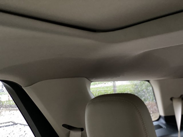

I have had an issue with water soaking the headliner in my 2020 explorer. Drove through a heavy rain storm last month and experienced this for the first time. Hometown dealership checked to make sure nothing was clogging the drain area of sunroof, it was fine. Can you please share how this was diagnosed where you had it fixed? Did they have to get under the headliner, or how did they discover the folded hose?
Mine had no headliner wetting or damage, it was all down the inside of the back side window, over the switches back there, into the below deck storage and into the spare tire well. Dealer did have to open up the trim back in the corner.
