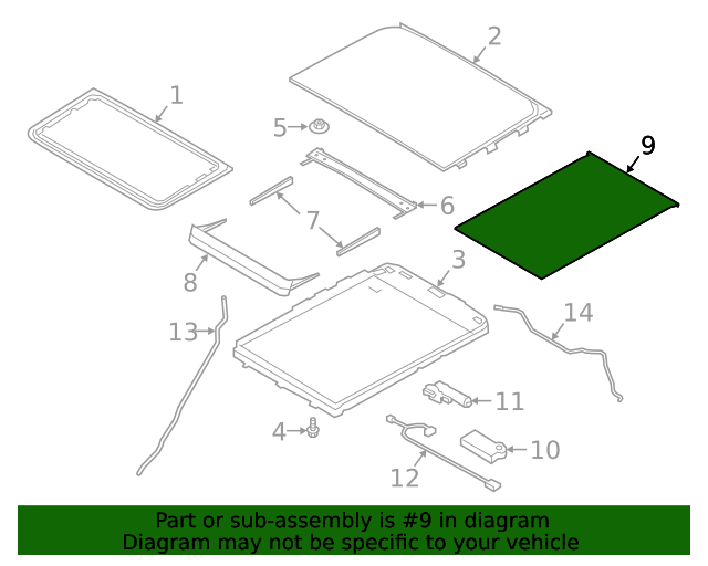

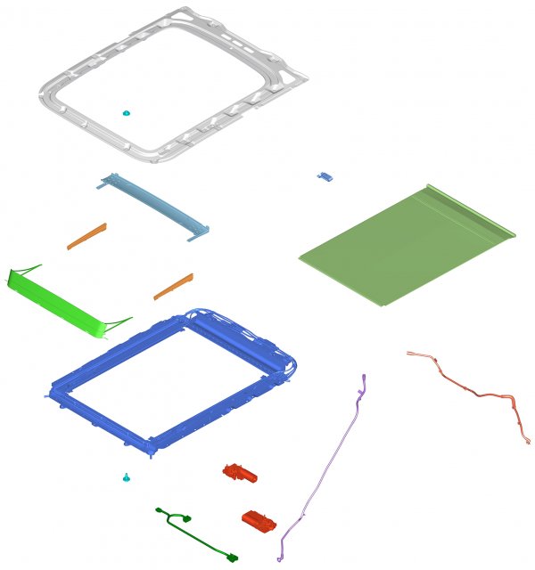

From Ford themselves:
https://parts.ford.com/shop/en/us/b...ng-roof-sunshade-panel-p-lb5z78519a02ab?pdp=y
It looks like there are not clips at all? Is it just that the roller has tabs at the end and inserts onto the track mechanism?
If that's the case then I imagine the roller has to be replaced, but that means you have to pull out the glass and get to the track?
Please tell me they didn't make something so crappy that you have to replace the whole roof?
I don't understand such a design flaw. It isn't the first panoramic roof Ford has put in an explorer.
It would have to be bean-counters saying "look how cheap we could make this"....
