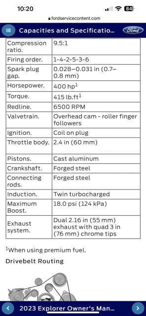

144
75
San Diego
Owner’s manual says max boost from the factory is 18psi.
