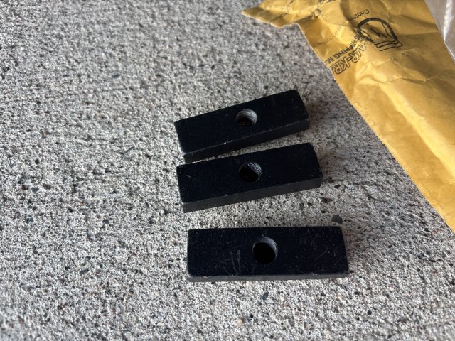

Installing a steeds brace the black frame connectors how did you guys hold them in place while putting in a the brace? image.jpg

Installing a steeds brace the black frame connectors how did you guys hold them in place while putting in a the brace? View attachment 30087
You don't. You got to be real careful lightly threading the bolts into them. I used a screw driver to line up the bolt holes with the bushing mount.
did you get the black thread going into it or the 15mm steel bolts? Thanks again
