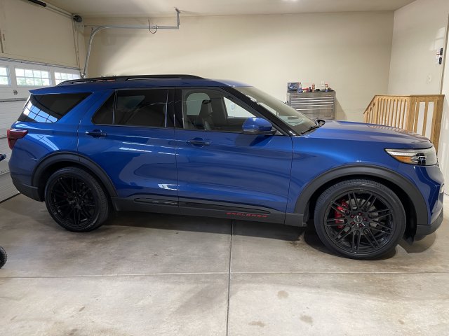

I had Steeda, they don't drop much and keep a rake. The Steeda rear springs began to corrode, so they set me new ones. I didn't replace them and went with Eibach. I like the ride quality better. At first I just replaced the rear Steeda springs with Eibach and left the front with Steeda to see how it rode. It was actually very evened out and rode well. Then just did the fronts with the Eibachs I had.

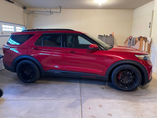

My 2023 ST has a rake with H&R's. My 2020 ST was pretty level with H&R's. Same wheels and tire specs on each. The zero rake kind of bugged me a bit on the 2020 so I guess I put that out in the universe and got new H&R's that were a bit taller in the rear. I think it has settled a bit in the rear since the photo.
955
648
H&R's on 2020 ST.
