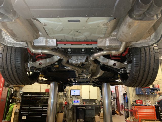

Just saw this thread - having the same issue with HR springs. Ends of the bar is hitting the springs. My guy is cutting the ends off but agree with everyone it should just fit.
anyone have any luck with Steeda getting a response?? B7625403-ED29-40A3-9D0E-DC80E10564ED.jpeg 59FA44E6-4B9E-4ABB-B046-963FB65592EC.jpeg F3E0409D-5261-421B-BA34-23E41CCC8987.jpeg
anyone have any luck with Steeda getting a response?? View attachment 1961 View attachment 1962 View attachment 1963
Yes I am working with Steeda now. I have to remove mine and provide them with measurements. Mine is hitting the stock springs.
