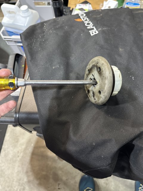

My rear diff brace and bushing kit has finally come in from Steeda. Took a little time this morning before the temperatures reached 100+ degrees, and tried to install the rear diff bushings. After a couple hours of trying to get the bushing itself out, I failed. Mind you the rear end is up on stands. It is not on a lift. I’m laying underneath it. So I put it back together changed direction and installed the rear diff brace for the time being. What an amazing product highly recommend it. My question is has anybody else installed differential bushing kit from Steeda and how did you get the bushings out? My next attempt is going to be on a lift, I would take advice anybody has. IMG_5161.jpeg IMG_5160.jpeg IMG_5159.jpeg Thank you in advance.

BeyondEOD
Active Duty U.S. Air Force
44
Missouri
1. Lower rear exhaust
2. Support under rear.
3. Remove the front differential bolts.
4. Using by a big screwdriver or pry put it in the bolt hole so you are only engaging the lower bushing. Pry hard back and forth to the absolute limit of movement until it pops out.
5. Disconnect the diff brace.
6. Remove the factory diff bolt.
7. Lower diff.
8. Using a large chisel/punch, hammer the other bushing out.
9. Install the steeds kit and button everything up.
