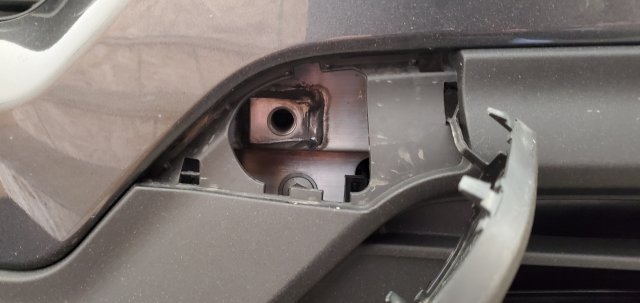

My first Explorer had the threaded hole behind the cover on the front bumper. Like most are saying, I wouldn't trust this option as a recovery point seeing it's only aluminum.

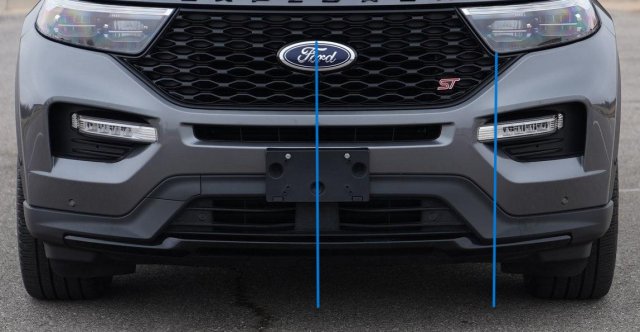

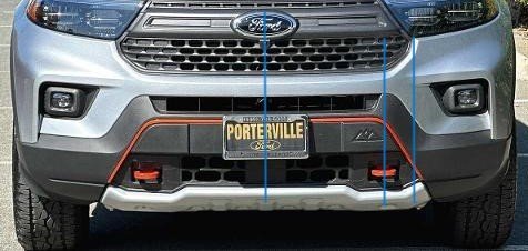

I wonder if the recovery hooks on the 22’ Explorer Timberline would be able to be modified to work on the ST?
372
303
The midwest

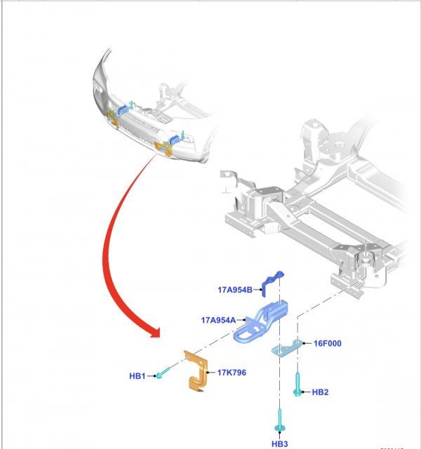

At least from the Ford drawing, there appear to be some attaching points on the frame that are used. Might be possible to adapt them if you’re willing to modify the bumper cover.
This looks like the best solution, but it seems it will depend on where it comes out of the ST facia panel??

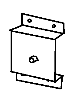

What about a sturdy steel plate, shaped like this, bolted over the front of the aluminum bar?

Looks like the Timberline hooks would come out very close to where the inboard sensors are on the ST. Would take a little cutting...
