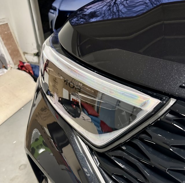

I keep noticing that headlights on my 12 miles new ST get easily fogged if there is water involved.
Is this normal or I need to take to a service for a leak inside?

Ford will say is normal but I would sent it back to get replace.

Agreed. I’d demand replacement.

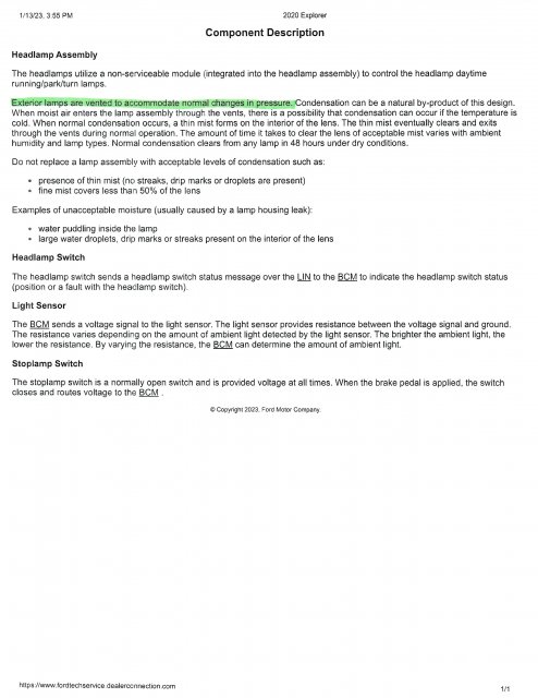

I've seen a Ford memo posted here before saying that their policy is to only replace them if there are large droplets of water inside.

Our headlights are fogging but not that much. I will not accept it as normal on such an expensive vehicle. Have an appointment booked to get it fixed.
