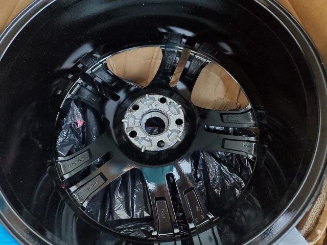

Look at this pic, see the recessed pockets between the lug holes? That is what I was talking about. If you have factory 20's you will have to open up the pocket a little but the 21's fit just fine.

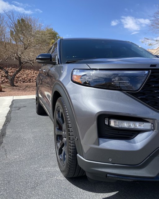

This is stock on the front and Steeda 1.25” on the rears. Also lowered on Steeda springs.
