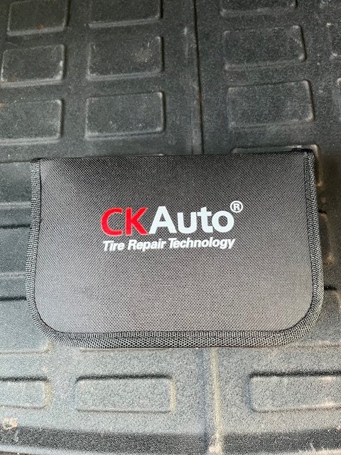

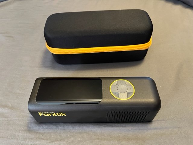

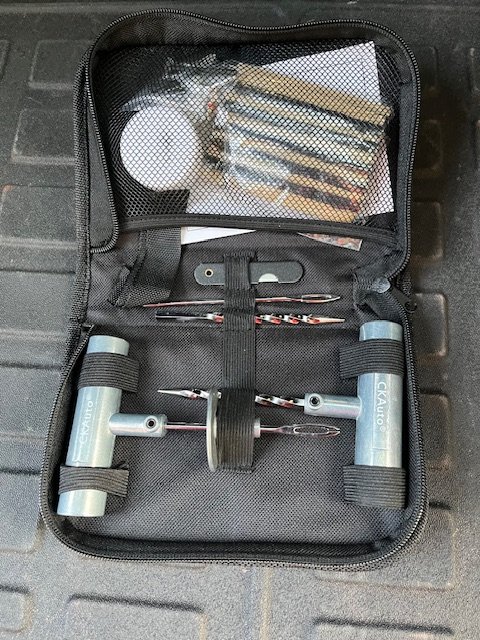

I just carry a tire repair kit and a small compressor. I can plug a hole and fill the tire faster than putting the spare on! If it's a front tire, you don't even need to take the tire off!
