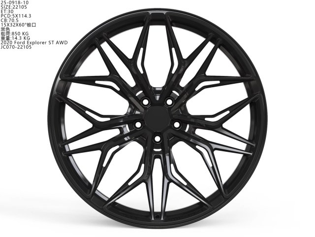

I am getting some wheels made and just am overthinking this process.
what I gave them spec information was.
5X114.3 mm
70.5 mm hub size
22X10.5 +30
2020 ford explorer ST AWD.
just wanted a second check to make sure I have the measurement’s correct. Thanks for the help

I also plan on sticking a 305 x35 tire or a 315 x35

Yep all that works. Perfect fitment for these cars.
If you have the factory 21's they run a 275-45-21 which is a 30.7" tall tire. The 315-35-22 is also a 30.7" tire so your speedometer will not be affected at all.

Here are the final specs
