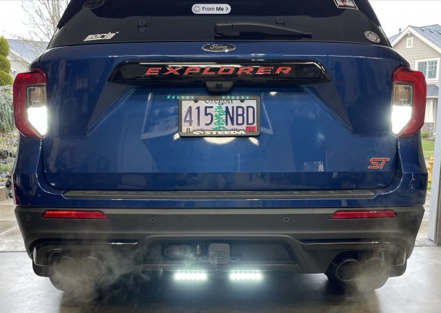

#20
Here is where I landed. Updated LED per link above for reverse and additional light. I like it, some will not.
What are those additional lights? Have a link?
