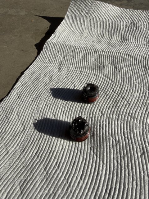

Like many others have mentioned, after installing the JXB bushing inserts I started hearing a very faint whooshing/scraping noise coming from the rear of the car. The noise is most noticeable around 25 mph and below while decelerating. If I add even the slightest amount of throttle, it quiets down.
I jacked the car up and checked the wheel bearings and they appear to be fine (no noticeable slop). The fact that the noise quiets with throttle seems to suggest the bearings may not be the issue.

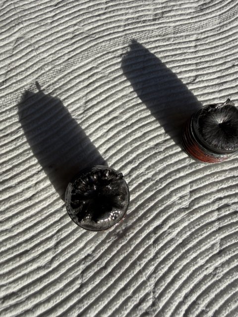

Next was a diff fluid change. I didn’t find any chunks or large debris, but there did seem to be an abnormal amount of metallic in the fluid and on the plugs (pictures included). I replaced the fluid with Amsoil.
Over the last 1,000 miles of normal driving (highway miles, and no hard pulls), the noise seems to be getting louder. That said, it could also be that I’m just paying closer attention now and turning the stereo down to listen for it.
At this point, I think I’ve decided to just bite the bullet and order a new differential. I have access to a lift, so hopefully we can make quick work of the swap.

I had the same issues with noise and also the same amount metallic buildup on the plugs. I changed the fluid to amsoil, took the bushing insert out and the noise went away. I’m going to wait until the noise becomes noticeable without the bushing insert.

Yeah that is a lot of metal.

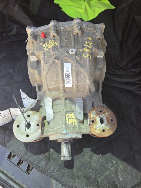

My diff arrived on Friday. Going to tackle it in the next few weeks hopefully. I will try to get some pics and maybe some vids and do a write up if it will help anyone out. Should be pretty straight forward though.

Replaced the diff this weekend and it fixed the noise that I was hearing, so that just confirmed to me that there was something failing inside the diff.
Process was pretty straight forward. I didn't get to take pictures as my time on the lift was limited, but wheels up to wheels down was right at 3 hours.
Removed both rear wheels, pulled the shocks, removed toe links, removed vertical links, disconnected sway bar end links, removed supporting brackets for brake lines, removed axle nut, pull forward and down on the rotor and pushed axle through bearing. Axles will now pull out of the diff. Removed Drivers side exhaust to make some room. Supported the diff, removed 2 rear diff bolts and then the two front support bolts. Slowly lowered down. The driveshaft will start to rest on the heat shield, then just hit the driveshaft with an air hammer. There is a small lip/edge that a rounded chisel bit will rest on. Once it popped free it lowered right out. Reversed process and hit it the opposite direction with the air hammer as I pushed the diff onto the shaft. Threaded the two front bolts and then the two rear. Slid the axles back in. It was a bit of a pain to get them back lined up through the bearings, but they went back eventually. Reversed process and bolted everything back up and took it in for an alignment.
6/10 difficulty on a lift. Probably a 9/10 on the ground if I had to guess. Definitely a 2 person job for several parts IMO.
