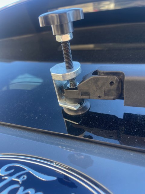

So much for an easy job.
I couldn't get the wiper arm off the shaft of the motor.
My only option was to cut the shaft off.
I hope these motors aren't that expensive if I ever want to replace it.
Sometimes my anger gets the best of me! :LOL::ROFLMAO::LOL:

Coulda been worse and used a hammer. Never good.

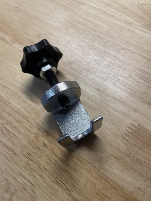

Bought this at Auto zone a few yrs ago. Had to nip off the end of threaded part to make it fit but it works great! IMG_1072.jpeg IMG_1072.jpeg

I had to cut off the wiper too.
