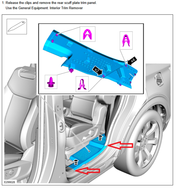

I have a 2020 ST and my problem is the
REAR DRIVERS SIDE footwell carpet is wet after a hard rain. It’s only the rear drivers side floor. I have not been able to figure out why or how yet. I poured water into the sunroof channels and I see the water is draining out on all 4 areas. It only when I park uphill does it get the carpet in the rear wet. I’ve been investigating and nothing is wet anywhere above the carpet. No wet seatbelts or headliner. It’s from underneath the weathertech mats. Couldn’t be a drip from above.
What would cause the water to channel down and only into this area? I’m so disappointed and confused.
Can you help?

Have you looked under your rear door scuff palate? Could water run down the trim around the wheel well and under the scuff plate when on a incline?
https://www.foexplorer.com/ford_exp...llation_rear_scuff_plate_trim_panel-1224.html
Dania Beach, FL, USA
You know what that is very, very likely. I will investigate today and get back to you later. Thank you so much for replying. I really appreciate it. This one has me stumped.
