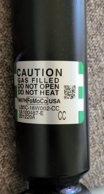

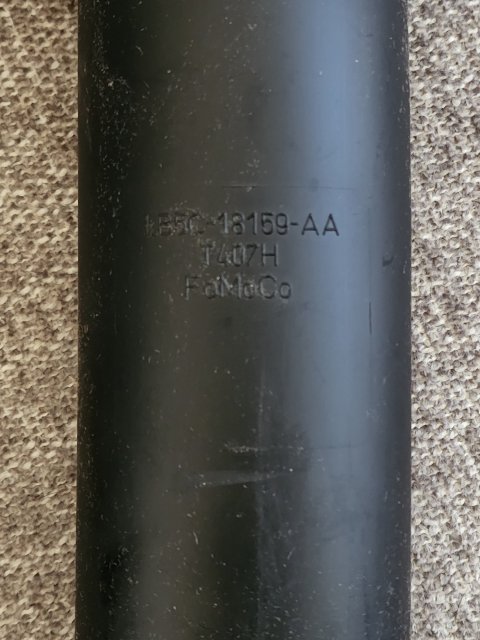

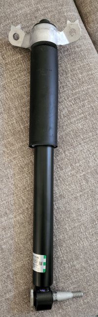

I got the shocks today and they have FoMoCo on each of the parts so I'm pretty sure they are OEM parts and from what I saw online RockAuto had the best price at $65 each.
I just need to verify the part number when I get the rear wheel off to make sure their site was correct.

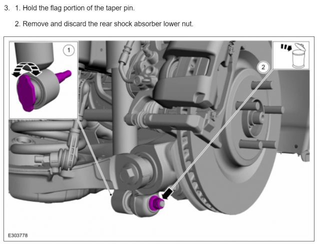

Did you have to "hold the flag" like it says? that bolt feels like it's pretty tight in that lower section of the new ones.
1,443
699
I don't remember needing to do that. Looks like simple pliers would do the trick if you do.

Awesome, they look like they are probably pressed in and might not move at all. Pliers or channel locks were what I was thinking if needed.

I got the new shocks installed this morning (part numbers matched up) and the old ones were leaking, not just seaping. I had no reason or need to "hold the flag" as the instructions pointed out. Thanks for the heads up @Cdubya , it was much much easier than I even expected [wrenchin].

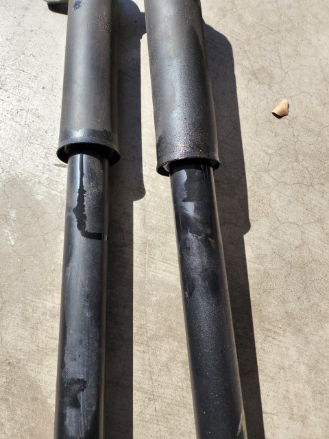

Showing the leak on both side by side.
1,416
1,132
That in my opinion is odd that both shocks would be leaking with that few miles on the car.
I have to say the thought crossed my mind that you had it in for an oil change and someone sprayed those with a little light oil and hoped to sell you something. Bad guy oil change shops use to do that.
I don't think the Steeda's would have anything to do with these going bad. The shocks are still operating within the range of the piston. Strange, very strange.
Do the old shocks still have their gas charge? If the leak is significant the gas usually bleeds off and won't rebound.
The dealer has been the only one to do oil changes so far, and the multipoint inspection from picking up the ST in May (first time after the long stint there) showed all good. And this was maybe 1500 miles later doing the first oil change on this engine.
I find it odd that both went at the same time as well, but in looking up replacement shocks I found a post on explorerforum.com where a person (also an ST) had both rear leaking as well, and they had stock springs.
I didn't check their charge, but can do that tomorrow since they are still out in the garage right now and report back how they are.

I did a quick test on the old shocks and they still have some rebound but not what I would expect. And the drivers side (leaking more) had less than the pass side.
1,416
1,132
I would think that would indicate the shock is actually bad.
