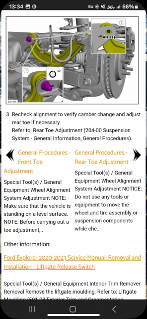

It’s -.5° and the decimal is extremely important.
if they don’t know where to adjust after the car has been out for over 5 years I’m not sure I’d trust them to begin with but it’s the upper control arm where it bolts to the frame. They’ll have to reach up high. After that it’s just a normal alignment.

It’s -.5 degrees, and everything else is OE specs. Show them this sheet and make sure they adjust this bolt. IMG_4168.png
