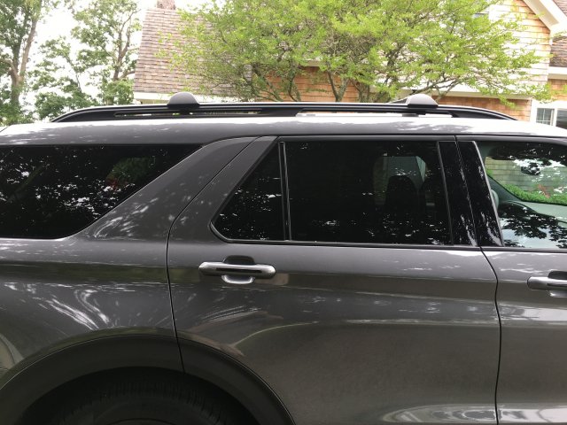

Anyone else have difficulty installing the Ford Explorer crossbars on their ST? I previously had a Ford Explorer 2017 Sport (ST predecessor) and had no issue installing the crossbars myself, and so I thought it would be similar. Different story with the ST. I can get the one side locked in but the other side won't fit into the side rail to lock in (see circles on image). It's almost as if the cross bar is too long. I could take it to the dealership to install but I like to have the ability to install and remove as needed. I also checked to make sure they are facing the correct direction, in the correct order, and also checked the install guide which says Ford Explorer on it.
1,469
717
That's really strange. I had no such problem with mine. Are both bars like that?
Did you try getting them to fit by angling the them to fit onto the rails and then making them perpendicular to the rails once the lower lip is under the rail?

I'm a moron. Your suggestion worked...it angled right in. LOL. Thank you!

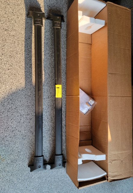

I measured the inside width of the roof rails: 47.75” front; 45.75 rear at the points where the rails could grip. So definitely should be different length cross bars front and back. My local dealer ordered a “kit” (says that’s how he has to order it) to compare to what I’ve got. Yup…my originals were both fronts which are too long for the back. He swapped out one of my fronts for a back, and I put them on.
I’m still not thrilled with distance I could get between them. I maxed it out because my likely payload is long (ladder, lumber, etc.). I appreciate the dialog I was able to have on this forum. Thank you! 19203929-9925-4B47-8033-180F9E3BCE19.jpeg

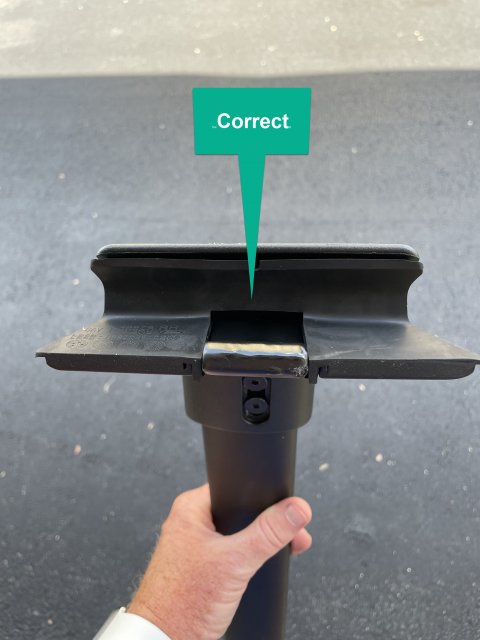

Got a set of these cross bars. Unalbe to connect the J hook to reach under the knotch where it is supposed to go. Rubber cover interferes. Any advice? The dealers guy who installs is on vacation until next Tuesday.
Fort Pierce, FL, USA
Got a set of these cross bars. Unalbe to the J hook to reach under the knotch where it is supposed to go. Rubber cover interferes.[/QU
Figured it out. In my box the Rubber covers were loose the box the J hook piece was bolted to the cross bar. So I just pressed them in over the J Hook, but the J Hook needed to be put between the rubber.

There is a front and rear which may make a difference. Try loosening all the way and reset screw. Mine worked after loosening and resetting rubber spacer. Hope this helps.
