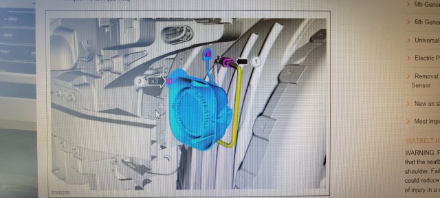

2022 ST
So I saw a video of a guy putting in an IC into a PIU and noticed the Whelen speaker mounted to the side in front of the Tire. I noticed it because I had an airhorn in my old 5th Gen and got me thinking of installing in my ST. here is a screen shot of the video and a link to to the video but I cannot find that same mount anywhere.
That's the mount I'm talking about, that's only the second time I've seen that particular setup. Let me see if I can continue to do some digging. On a side note my previous vechicle was a tacoma and I had plenty of space and no intercooler to worry about. Ideally I'd like to mount my rumbler as well, but bare minimum I need a speaker, I've already gotten a warning so I need one ASAP before MDAD decides to do a "random" vechicle inspection on me.
