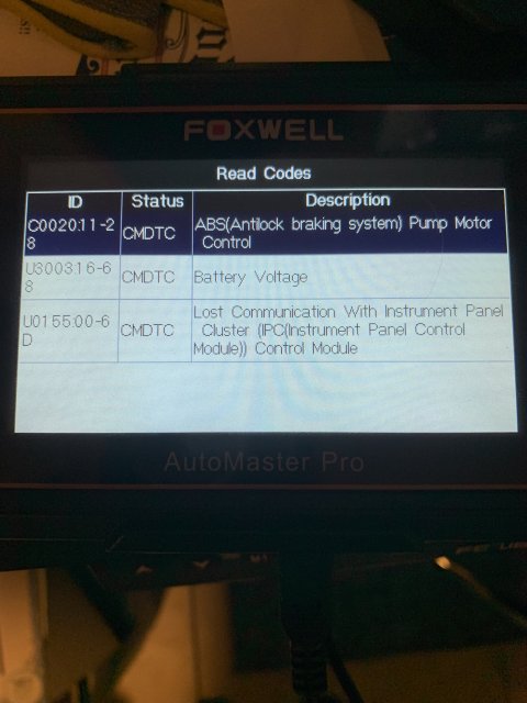

And now today, nothing. The compressor stopped engaging the clutch. Ok, so I went into my scanner to see if there was something inhibiting it from turning on (ie. temp sensor etc.) and I found nothing. So, as I am not a mechanic my next step was to check the Hi and Low side to see if it had leaked. That is where my diagnosis ended as it made more sense to hire someone to come out and run their own diagnostics.
The mechanic came out and was able to conclude the system did not have a leak, but though his troubleshooting, he concluded that there was a corrupt file on the PCM! His inability to be able to see the status of the compressor led him to look into the computer and see if it was commanding the compressor on. Thats where he saw that there was some kind of discrepancy, and it wouldn't allow him to see the activity through the PCM. His diagnosis was that the PCM needed to be reflashed and updated to correct the problem.

To answer your question, no there was no CEL or DTC present. I did notice this afternoon when I was working on it, there was a fault with the ABS module. There was an issue with the pump motor control, battery voltage, and lost communication with instrument panel cluster control module.
EDIT- I also observed that the freeze frame from the ABS fault event had recorded the external temperature sensor reading 415* F. I believe that this is also around when the A/C stopped working. (I don't think it takes a mechanic to know it was nowhere near that temperature anywhere in or around the car).
Coincidence? I have no idea, but that was something that I had observed.

Well I suppose that I have more that one issue at hand here...
In hindsight, I had noticed that an ABS fault had been stored in the past.. I got a CEL for the purge canister solenoid valve which I replaced about 2 months ago, but I saw the ABS issue and just cleared it not thinking anything of it (I chocked it up as it was "just a ford thing").
Guess I should have looked into that further. A wire problem seems like the only likely cause of this. hm..
My location isnt prone to rodents, but we did buy it from a dealership in Texas and I believe that it was originally purchased in Florida..
Now that I am thinking a little further into this, I am beginning to think that a reflash of the PCM may be a solution to a symptom and not necessarily the bigger problem at hand.
EDIT #3- Yes, all fuses have continuity.
EDIT #4- Now that I've looked through some wiring diagrams through Mitchell, the ABS module is connected to the HVAC system through the auto start/stop (to turn the A/C off during auto stop conditions)..

So, I followed a flow chart on Mitchell and the first problem it said was to do exactly what you said. First diagnose the U3003:16 code which is for the battery voltage before moving to another step diagnosing the other two codes.
Once again, "in hindsight" I have been getting notifications on Ford Pass that "Some features have been disabled" due to undervoltage of the battery... That issue has been intermittent so foolishly I have brushed it off.

So- my first step was to take it to the dealership. I get a call 3 days later stating that the fuse block had an internal failure and needed replacement. It is my understanding that the relay modules for components such as the A/C system are integrated into the BJB (body junction box?). Since my warranty covered it and the labor, they proceeded to replace and reprogram the fuse block... I get a call a couple days later stating that the work was done but still did not have compressor clutch function. They said that there may be a short in the wiring harness and that the next step is to trace that out. They find the short in the harness near the front bumper of the car and fix that... Still no A/C. Finally the last and only thing they can do is replace the compressor. So they replace it and viola! everything is back to normal operation.
So who came first, the chicken or the egg in this situation? I guess it doesn't really matter since all three issues are now resolved regardless of who is to blame.. but hey! were back to cold air just before they hot days roll around.
I am going to monitor for the ABS trouble code moving forward here just to see if that fuse block replacement solved more than one issue that I had. I had the opportunity to replace the battery but according to the tech, they ran the test and turns out, it was still good.
