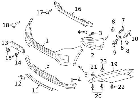

For those of you that have removed your front bumpers, is part #7 the two bolts (on each side) holding the bumper cover on? These are the bolts that are difficult to reach. Site for reference. I want to get replacement bolts as the heads on 2 of them are a little stripped.
