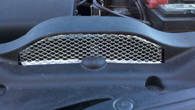

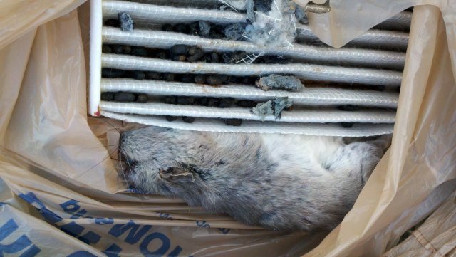

As they say today; "if you know, you know" but I guess everyone doesn't. I found out the hard way back in 2013 when I traded in a Buick for a Toyota. I reside in a rural area and it turns out that car manufacturers (primarily Asian brands) have adopted soy or plant based insulation for their vehicles wiring. Rats and mice find the smell of this material tempting and will proceed to eat your vital electronic cables disabling your ride and costing you hundreds or thousands of dollars.
Within weeks of getting my Toyota I smelled something vile when entering the vehicle that only partially improved when I cranked the AC. Upon further investigation I found a large dead rat in my cabin air filter and a number of wires and the sound insulation panel under the hood had been chewed up along with telltale fecal deposits everywhere. The dealer sheepishly admitted to me after the fact that this is a known problem and even at their business they have to deal with hangry rodents. Remedies include the aforementioned mothballs, fox urine spray in the wheel wells, dryer sheets, peppermint oil, various traps and predatory felines. Also using gutter guard cut to fit larger ingress points under the hood or air intake can be helpful. Hope you never find out.
Thanks, seem to learn something new almost every day on this site. I have a roll of that screen material, used for vents on my storage shed.
