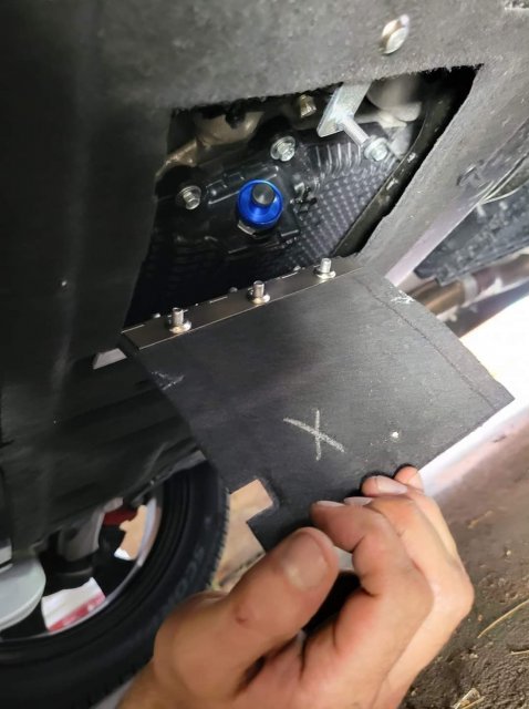

That plastic oil pan and drain plug though, ewww, I might have to get a proper skid plate.
I’d recommend getting the UPR drain plug. Lots of people swapping over to eliminate that plastic oil plug that is supposed to be replaced every oil change.
I also use the UPR and have quite liked it.

I would love to have a skid plate for my ST. It probably would not be hard to fab as the fibre cover appears to be pretty flat, but looks could be decieving.

Kudos for thinking out of the box !! I still have that oil plug sitting in the tool box. One note on the MityVac 7201 oil suction pump... it seems if the engine is not fully warmed up the smallest extraction tube will not go all the way down the dipstick orifice and you can't get all the oil out. Makes sense the engine parts had not fully expanded yet including the inside diameter of any orifices. The time of year and the temp in the garage could also expand and contract the smallest plastic extraction tube of the MityVac 7201. So two oil changes with no issues then the last one, with minimal warm up, was an issue getting the tube in all the way. ;)
