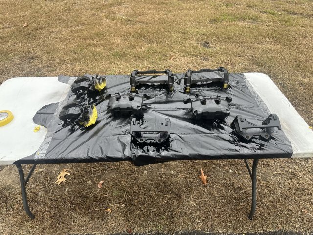

I went with black High Heat paint, I wanted to be different. LOL
