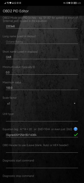

The Ford Octane Adjust Ratio (OAR) is a system that adjusts the ignition timing to improve engine efficiency and power. The OAR uses feedback from the knock sensor and fuel quality to determine when to adjust the ignition timing.
How it works
  • The OAR starts at 0.0 and adjusts towards -1.0 when conditions are optimal.
  • When conditions are sub-optimal, the OAR adjusts towards +1.0.
  • The OAR controls access to load limiting tables, which are for low, medium, and high octane.
  • The OAR adjusts the ignition timing to improve engine efficiency, fuel economy, and power.
Why it's important
  • The OAR helps the engine self-tune to use the highest octane fuel that's available.
  • The OAR can improve engine efficiency, fuel economy, and power.
What it means for you
  • The OAR can help you determine if you're getting knock and if you need to use a higher octane fuel.
  • Custom PID for torque PRO in Attach File

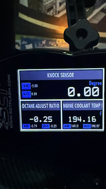

I stopped monitoring OAR the week after I started tuning my Focus ST. Use good quality fuel and it'll always be -1.00.

In my country, gasoline is of very poor quality.
It was almost always at 0.8, but when I used 93 + E10, it went to -0.9.
