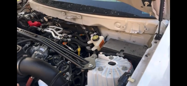

So my dealer states that they have to drain the coolant system in order to change the plugs. I've never heard of this, you merely just need to unbolt the coolant line bracket and move the lines out of the way.
Has anyone else experienced this?
Coolant lines do not need to be disconnected. Grab a tech and ask them directly if they disconnect the lines. Then you can talk to the service writer and have a fun conversation.
