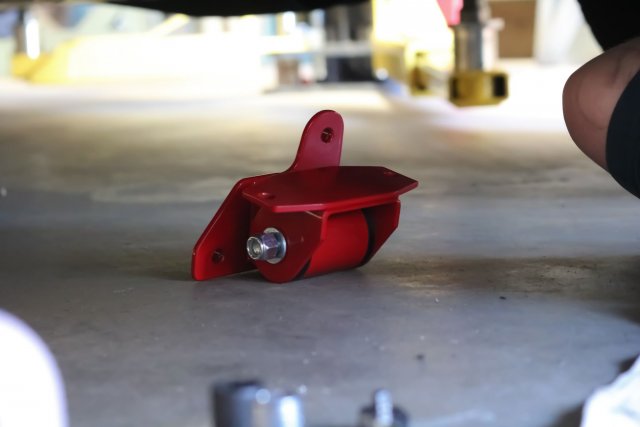

NEW Product Alert! Introducing the AWR Racing rear diff mount for the 2020+ Explorer ST
AWR has done it again with unmatched design and build quality in this mount.
The AWR diff mount is available now for pre-order at whoosh motorsports at the introductory low price with FREE SHIPPING in the continental USA.
complete product details, installation, and additional pictures are live on the site : https://whooshmotorsports.com/.../awr-racing-rear-diff...

I've got a Diffy Stiffy not installed yet. But I also have a subframe on order. I'd say this one definitely looks beefier than the Fenfab. It also doesn't look like it has slots on the diff plate. I worry the slots in the diffy stiffy could allow movement under duress. If I were choosing one today instead of a subframe I think it would be this one.
1,692
1,451
I've made my opinions on the Diffy Stiffy well known on this forum. https://www.explorerst.org/threads/...oom-from-emergency-auto-brake.2148/post-36529
This is a definite step up and yet...
Read the post as to why I find the concept at fault, and then look at this design- BTW, I'm seeing just these pics, so perhaps I'm missing something, but ask yourself these questions. Is it truly limiting z-plane travel? Will a single bolt in the differential cover that's offset to the force be enough? Why Is the rotating motion of the differential in the same plane as the rotation of the 'isolator'? When I look at this design, I see something that would be very good at busting the diff casing around the single bolt during wheel hop.

That's my one fear about both products. They are depending on cover bolts and aluminum structure around them that were not likely designed for the stresses that the bolts on top of the diff were designed for. Again though just makes me question why the heck they dropped one of the bolts for the performance model. And also the reason I am forking over to make it correct....at least in my mind :)

there are 2 diff bolts holding the mount in place
My initial thoughts on seeing this mount was that it was a huge step in the right direction, but with a single differential mounting point (bolt) where the line of force would be directed towards the thin side of the differential casting, it looked suspect. I looked at all the pictures on your site Ron and couldn't see where the second differential mounting bolt is located. That being said, if it's on the differential on the RH side placed inline with the diff casting in the line of force (thicker up-down), then I'd say this mount looks like money well spent and certainly cheaper than buying the subframe.

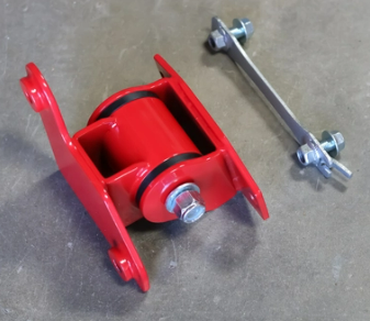

here's a pic of the diff plate from another angle
