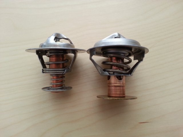

The $40 means nothing to me as well, but to plenty it does. I had been selling a similar thermostat to the Mustang Cobra crowd for years: it was only about $25 less but hundreds of them moved easily. Most guys that turn their own wrenches dig bargains.
This particular one also fits the Coyote engine, and I had sold lots of them as well. When you buy some of the aftermarket off-the-shelf thermostats (like ones that many think are the "right part"), especially with lower temperatures, they are more often than not shorter than the OE length. With that, they don't seat properly and the system doesn't function as it is supposed to do. This is why I sold another version to the Cobra guys since the MotoRad 170° (off-the-shelf) was not the correct length. Could be exactly the case here...
Perfect example of why I sold my Cobra version that was an exact fit compared to another:

Don't need to: the thermostat I wrote about has the same dimensions as the OE Motorcraft RT1225. Again, has been used in the 5.0 Coyote for years and is an exact fit. Can't say the same about the one at the top of this thread, but you'll find out soon enough.
From my other site: http://www.termi-stat.com/coyote.htm
