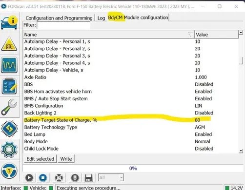

While I did not have the same dash errors you did, I did have fluctuating voltages, dipping down below 12V at times. New battery did not help. BMS sensor replacement seemed to help temporarily. I did not replace the alternator because like you, I got rock stable 13.5-8V when the BMS sensor was disconnected. Only thing that helped was changing the Battery State of Charge setting from the default 80 to 95%.
I have all modules fully updated as well.
Not my pic but here is the setting in Forscan:

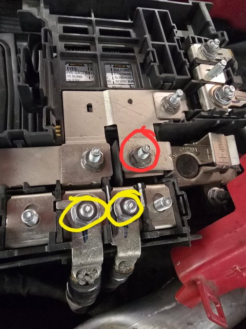

Well first off thank you everyone for the support in this. Secondly the last little hail Mary that happened to be free was the answer. When I swapped the battery I only loosened the two nuts circled in yellow and obviously the one securing the the positive terminal. Well turns out the one circled in red was over 3 full turns loose even though I never disconnected it. Tightened it and immediately saw voltage under power in the mid 14s.
Thanks again everyone for being so quick to help me sort this. Forgot the picture! 20251015_131232.jpg
