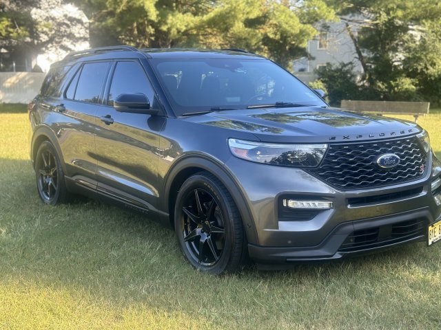

I went with Eibach over H&R for the slight rake - I usually have 2 adults and 2 kids in my ST.. You really can't install the springs on the wrong side or wrong direction. Once you put them on the spring perch you will see the orientation and the springs are usually labeled.

They have been installed about 6 months. The photo I uploaded was 2 weeks ago or so. That is where they settled. I was next to a ST with H&R and I was slightly higher with a rake. They were more level. Eibach recommend trimming of the bumps stops and I forgot to. But I don't bottom out. The ride was a bit bouncy at first, but once aligned and driven got much better. I am running 275/50/20 tire so I am not sure how they feel on Factory 21" or 22"

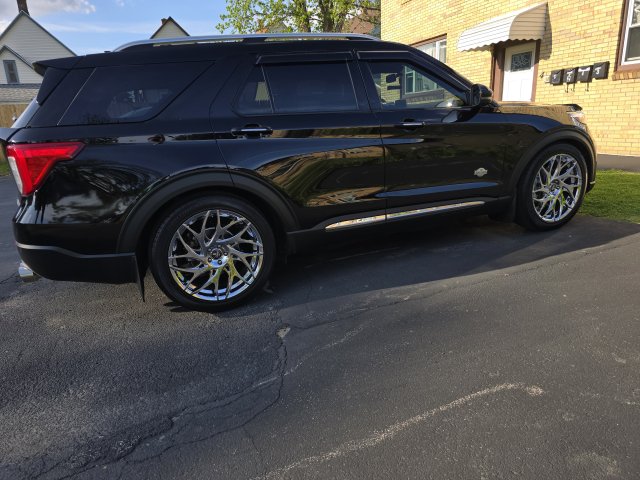

I went with Lethal Performance 2" ones ? Yikes , its close
Killer stance tho'
