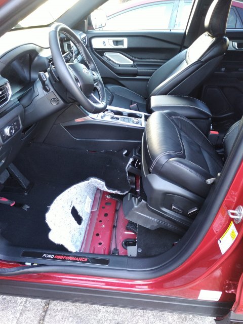

Well I have 2700 miles now on my 2020 ST that has a build date of 09/20. From day 1 I noticed a noise coming from the driver's side when you steer hard or apply breaks hard or gas it a little.

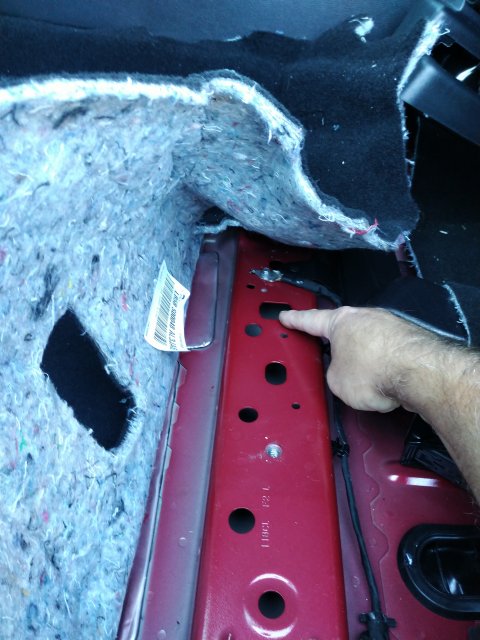

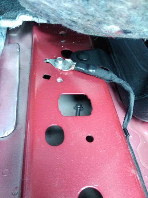

Today I decided was the day to find the cause of the noise before I loose my mind. I got my wife to drive while I laid down in the back floorboard while I listened under the driver seat, I could hear the noise very clearly!! It was a repeatable noise so I knew it was a object that had to be rolling around. I pulled the driver seat out rolled back the carpet and I spoted the problem immediately!! A screw that the assembly line person uses to fasten a ground under the seat was left inside the floorboard boxed in area and thus would roll around making a noise like a pinball in a pinball machine rolling!
