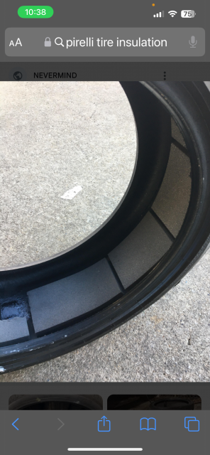

Could be the insulation in the tire causing the vibration. A lot of people have had this problem.
insulation IN the tire???
3,252
1,439
Yes stock pirellis have insulation in the tire that are supposed to help with road noise. It can detach and cause misbalancing.

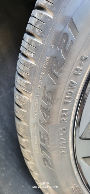

Mine don't have any indication on sidewall
Interesting approach
They won’t show anything on the sidewall. Hopefully the tire is just misbalanced because it is expensive to get the foam scraped out.
IMO it would be an easy removal
4 new michellins (y)

If your tires have PNCS on the sidewall they have the foam inside.
Mine are not pncs
I checked sidewall and pirellis sight.
They didn't put them in 23s
