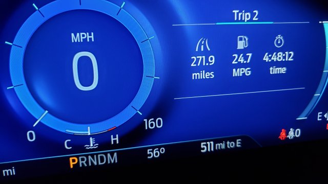

just came back from a 1700 mile road trip, cruise set at 80 most of the way, tucked in behind an 18 wheeler as a wind breaker for an hour or so, saw an average MPG just over 24.
with mixed driving at home i see around 20.5 avg
i forgot to mention, i did dial the knob to eco mode while on the highway.
