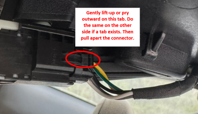

I finally got the cover off but how the heck do you disconnect this connection? I'm trying to add a Dongar power tap for a dash cam.

This is what it looks like to me from your picture.

Thanks yeah you’re right. Too my old bifocals eyes it was hard to see and I thought it was further back. But I got to looking at splitter cable and it made sense.
need to not be in a hurry.
Dongar splitter worked great.
