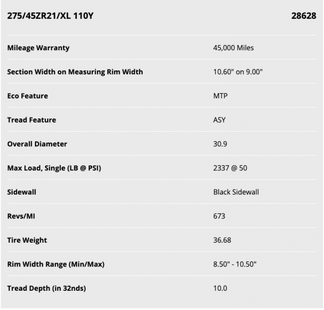

Will the pilot sport as4 be ok on the stock 21 inch rims? I just placed an order today but now see that there are pilot sport 4 SUV tires. Should I have ordered the SUV version? I’m already on h&k springs with the bora spacers on the way.
zdubyadubya
813
652
Assuming you bought this particular model of AS4 tire, you are just fine. Its just the load index that matters. A 110 tire is appropriate for this vehicle.
L
lwlf13
Haymarket, VA, USA
I don’t think mine has the Z, but everything else matches. I’ll call the shop to confirm tomorrow. Thanks for clearing up the correct spec.
I think this is what I ordered: 275/45R21 110Y
