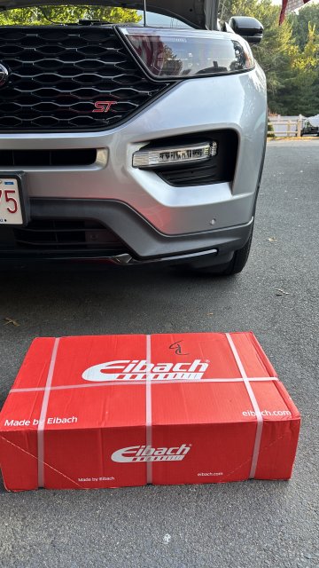

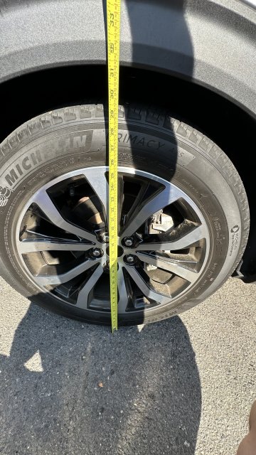

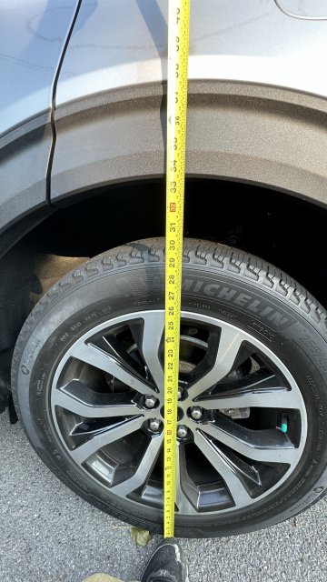

Starting the build on my 2020 ST with lowering springs from Eibach.
Before lowering:
Front - 33.25” ground to fender
Rear - 33.5”
After Lowering:
Front - 31.25”
Rear - 31.75”

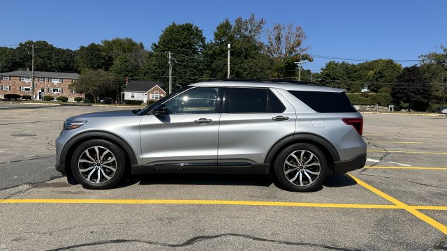

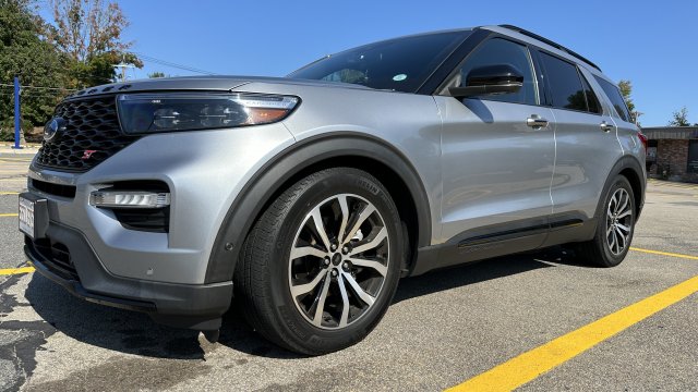

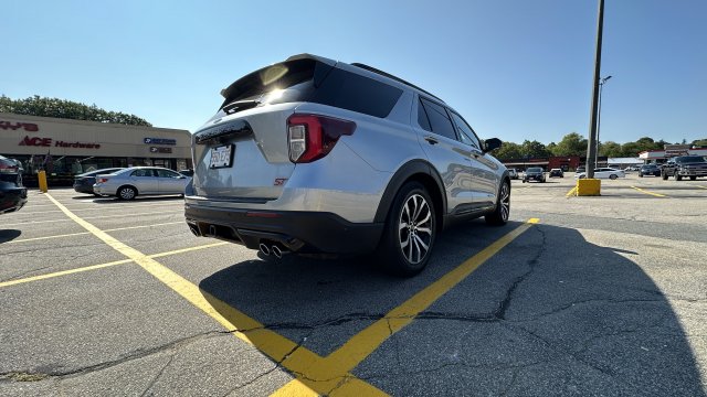

Needs a wash but profile picture:

Nice pics! Just a suggestion, if you could take your measurements from the hub center to the wheel lip edge that will give everyone no matter what wheel/tire combo they’re running the same measurement. Thanks!

I did realize that Eibachs lower that much. I went with h&r and after 200mi. the drop is 1.3f and 1.5r. Looks like eibachs dropped full 2" in the front.
Looks great thought!
