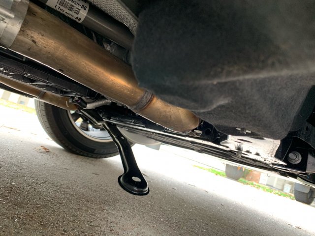

Interesting - a day or two after I bought mine earlier this month, I noticed a metal on metal noise on startup when cold. I’m scheduled to take it into the dealer on Monday to get a loaner while the dealership addresses it. I was at my brother’s today. showing him my ST and noticed a crossmember loose below what appears to be the transfer case. A bolt is missing and the part is moving freely beneath the vehicle. I’m wondering if this is the metal on metal noise I was hearing. Let me know if you were able to resolve your noise. Happy Thanksgiving! 3387EB5C-41B2-42DB-97F7-44EB6A37BF25.jpeg

Interesting - a day or two after I bought mine earlier this month, I noticed a metal on metal noise on startup when cold. I’m scheduled to take it into the dealer on Monday to get a loaner while the dealership addresses it. I was at my brother’s today. showing him my ST and noticed a crossmember loose below what appears to be the transfer case. A bolt is missing and the part is moving freely beneath the vehicle. I’m wondering if this is the metal on metal noise I was hearing. Let me know if you were able to resolve your noise. Happy Thanksgiving! View attachment 2695
Wow, I am astonished that they sent the vehicle like this out of the factory, what kind of quality check are they doing?
