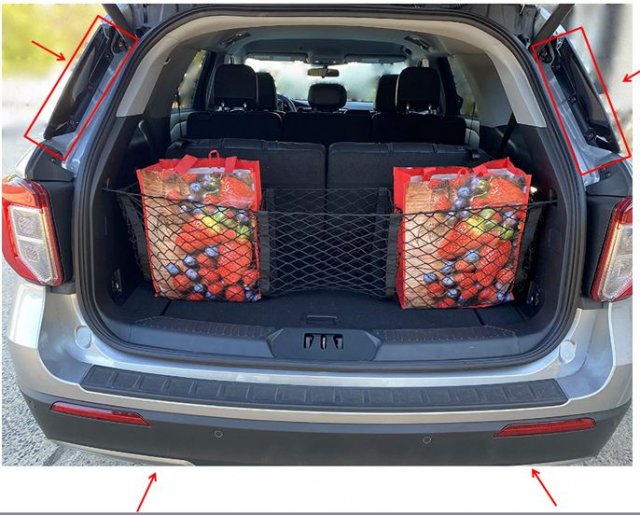

Coming out of Costco last week, I opened the rear liftgate on my 2021 Exp ST and loaded the groceries. The liftgate opened fine, but would not close no matter what I tried. I finally had to close the liftgate manually by pushing it down to close. That has been that way until yesterday.
I spent every day since then researching and googling to find a solution. I even purchased Ford’s Service manual, thinking it was a wiring or mechanical problem.
My wife just told me yesterday about a woman on YouTube having the same problem with her 2020 Ford Expedition. She cleaned all the sensors around the liftgate and it started working again. I said, no way! That’s nonsense, nothing is ever that easy!
So, when my wife left my man-cave office, I took a fiber towel and a small bucket of water, ran outside and cleaned all the sensors around the liftgate.
Honest to God truth, that S.O.B. liftgate started working again! I said, no F*#$@n^ way! I tried 8 to 10 different times using all 4 ways of opening and closing the liftgate and it has worked every single time! Lol… Not telling my wife. I won’t hear the end of that one.

There are 3 areas near your rear liftgate that have sensors. Two long strips on the inside of the tailgate and body (right and left side) and two strips “under” the rear bumper (right and left side). Sensors look like plastic strips held in by plastic buttons. Just clean them with a little soap & water like when you’re washing your truck and they should be fine. If after cleaning your sensors and you still have problems, then it’s probably not your sensors.

OMG- your solution worked! I tried to make an appointment to my Ford Dealer Service and all advisors were busy and started looking for solutions online. Thank God I stumbled upon your response. I actually just got a paper towel moistened with glass cleaner and immediately- problem solved. Thank you!
