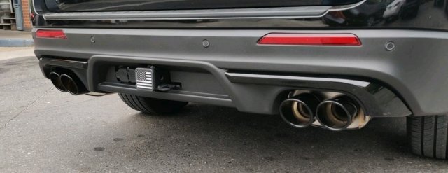

It might be early signs of OCD, but my exhaust pipes are not level. It is almost an inch higher on the left. This has slowly been driving me crazy. To level these out, do I loosen it up further down the pipe to make adjusts?

Loosen all the clamps and adjust from front to rear. With yours I’d start at the clamp at the rear of the mid-muffler. There’s also a little slack in the rear hangers...if you loosen the 10mm bolts you can slide them up or down just a bit but somethimes that’s all you need.

That is what I was hoping to hear. Thank you for the feedback.
