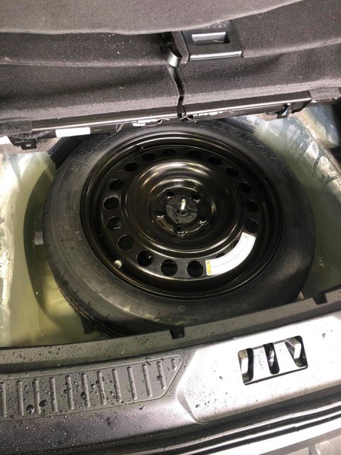

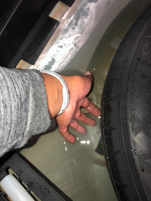

Saw someone on FB share this. Checked min and all seems fine. Their spare tire compartment is completely full of water.

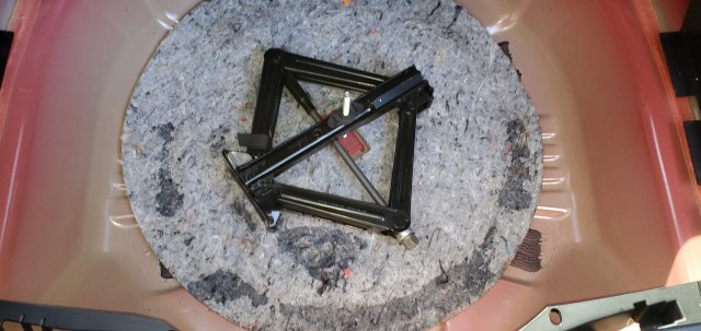

I suspected I had a leaky Right Rear Quarter panel window and spoke to the local dealer about it. Service Manager hadn't heard about any such issues, though he had another ST coming in for the same complaint, he'd schedule mine after our upcoming SoDak trip. While on the trip, discovered I had a very annoying high pitch whine (Really, it wasn't me) in that same area, then while driving down some washboard dirt roads in the Badlands, heard a constant creak/squeek/damn annoying sound. Had my wife drive with me in the far back and nothing I put pressure on including pushing pretty hard on the RR1/4 window would stop that squeek. So After cleaning off some of them there crickets (see pic below)
We found the trail of water in that quarter window leading down to a ...
.very wet Spare tire well pad
All drying in the sun now, back to the dealer

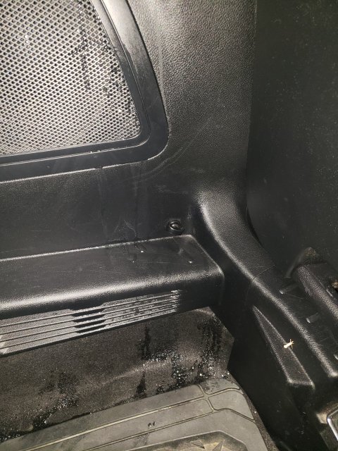

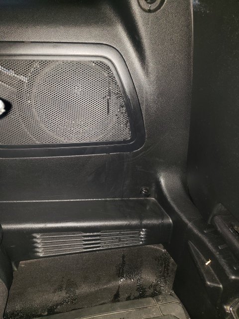

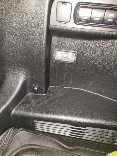

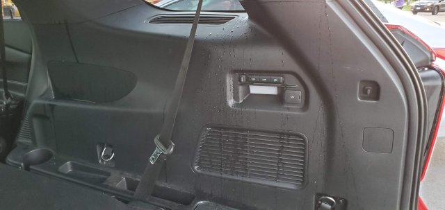

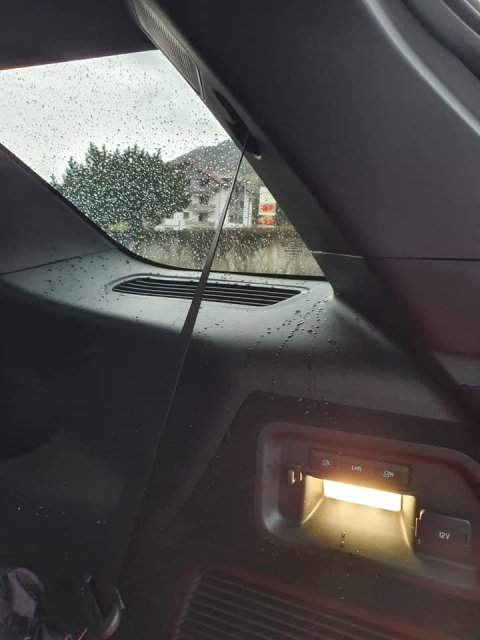

I just discovered this problem in my 2018 Limited. It's a severe thunderstorm happening right now and I parked in the supermarket lot and crawled in the back to get my wet weather floor mats and found water coming through my speaker vent and side panel behind the 3rd row and also on the driver's side behind the third row and coming through the side panel light. I'm seeing this complaint on more than one forum. Ford needs to do something about this. 20210923_132546.jpg 20210923_132546.jpg 20210923_132602.jpg 20210923_132926.jpg 20210923_132546.jpg 20210923_132602.jpg 20210923_132926.jpg
