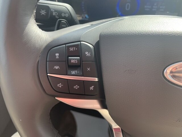

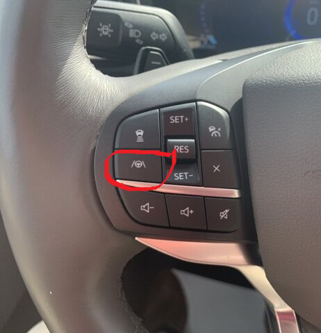

To better understand, does that green/orange steering wheel not appear when you press the button circled below?
That button only puts on the lane assist, not Intelligent ACC.
My Adaptive Cruise Control is setup for Intelligent (it's located in the center console under Assistance).
When I turn on Cruise Control and RES from the steering wheel's buttons, the speed is set to whatever Tolerance you setup over the speed limit (also located in the center console).
Then the green steering wheel comes on. It should look like the image below. Then your vehicle is turning to stay within the lane and keep yourself from hitting any object in front of you.

Try pushing the button to re-engage lane-centering. Like the previous poster's pic shows. That button probably has been reset to off position and needs to be turned on again. If it doesn't reappear then turn green when lock-in at speed then something is wrong.
I must have been pushing the wrong button when @PlatinumST suggested it because now it's working. Thank you both for pointing me in the right direction.
