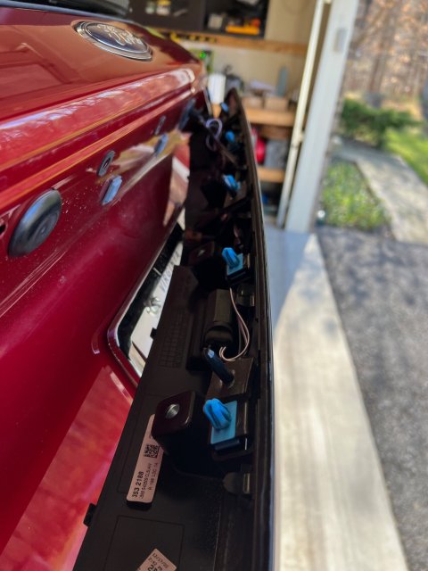

Start by removing the plastic from the inside of the lift gate. Next you'll have to remove the spoiler. In my opinion, this was the worst part. There's three bolts, and about 8 clips.
You have to remove the pinch sensor and move it aside, then you can release the circled clip for the lower part of the spoiler.
This is the Y tube that you'll replace the stock one with as shown below.
The tube clipped into the brake light mount will connect to the next tube below.
The clips were already in place on the existing harness, so just line those up and snap it in. The tube was facing the wrong direction initially, I just had to spin it around and it connected right up. Didn't take A pic of this tubes package. It part number is LB5Z-17A605-W.
Next you'll remove the rear trim with the camera. There's six bolts on the outside of the vehicle with a handful of clips. It's a little easier to release the clips from inside the lift gate. Not much easier. lol
Behind the trim, you'll see a blank plug. Pull that out and you'll install the next hose.
Connect that to the tube inside. I forgot to take a picture of that part, but it's fairly self-explanatory.
Next you'll remove the camera from the rear trim to install the sprayer nozzle.
Just pay attention to how the nozzle blank insert comes off and put the nozzle on the same way. Be careful with the connectors.Connect up that tube and put the trim back on, and that's it. Hopefully I covered everything.
