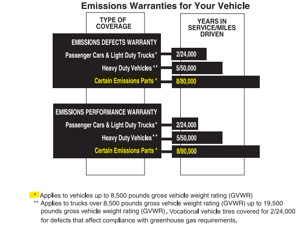

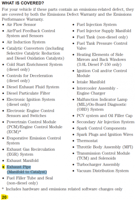

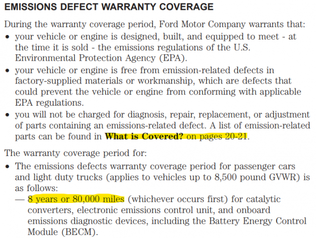

Isn't this a covered item under Ford emissions warranty?
