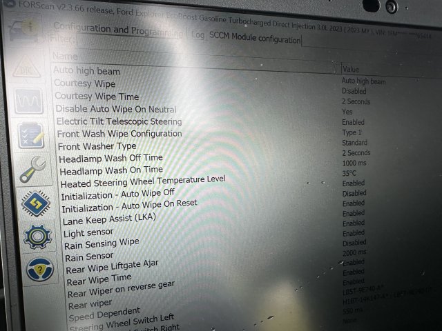

Can this be adjusted in forscan? I think I changed it higher on my old 16 limited.

My ExpST wheel gets pretty warm, so no problems with it. My Raptor wheel definitely gets a bit warmer than the ExpST, but both are really comfy when it’s cold out! They both cycle on/off when it gets to the set temp. If you leave them on for a long time, the metal core of the wheel retains the heat and causes the surface element to shut off more often such that it feels cooler.
I don’t have the info handy, but the steering wheel temp can be set/adjusted via FORScan. However, the hotter you set it, the more likelihood of damage to the leather covering of the wheel. There are a few threads on the Raptor forums for steering wheels replaced due to the heating element outline showing through the leather cover too much.

For those who have Forscan and want to adjust the temp, the setting can be found in the SCCM module. The default (or at least what mine was set at from the factory) is 35C. I dropped mine down a few degrees as it felt a bit too hot to me.

Do you have any insight on how to change it via forscan? I'm having trouble finding that myself. My wheel only gets kind of warm.
It's in the SCCM Module. Default temp is 35*C

ANd just to add to this thread. My wheel gets HOT. I usually turn it off after 2-3 mins as it's pretty darn toasty.
I might try and knock it down from the default 35 degrees to something a tad lower.
Found it in forscan thanks to you and @Mustang5L5 . My wheel still does the same thing. Heats up kinda nice for about 30 seconds then seemingly goes away. It is about 80 degrees where I live. Do Ford's have something where it disengages the HSW if the temp outside doesn't meet a certain requirement?

Not that I’m aware of.

Was 86 the other day. After riding for a bit with the AC on so the interior was nice and cool, i put the heated steering wheel on. Left it on for 2-3 mins before turning it off and it was nice and toasty.
