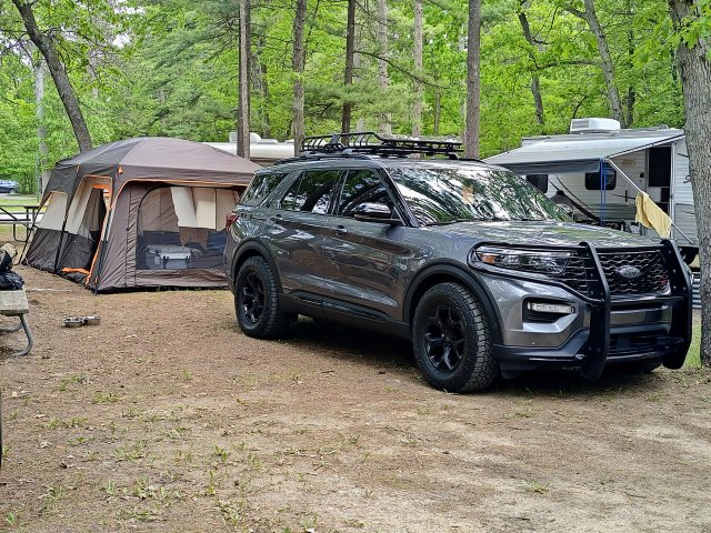

@Chrisicle what size tires are you running with your 18’s? Yours looks great. I am going to replace my wife’s 21’s and do exactly what you suggested.
23 Explorer ST
587
273
I’m running 265/65/18 Falken Wildpeaks.
